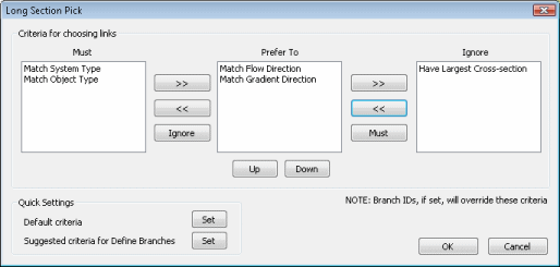

This dialog is used to specify the criteria to be used when creating long sections using the
button from the
GeoPlan Tools Toolbar.
It is displayed when Tracing tools
Long Section tracing settings is selected from the GeoPlan menu or when changing branching rules from the
Define Branches dialog.
Click Default criteria Set button to select the recommended criteria for displaying a long section in the Long Section View.
Click the Suggested criteria for Define Branches Set button to select the recommended criteria for automatically generating Branch IDs. (See the Defining Branches topic for more information).
Use the Up and Down buttons to adjust the priority of the Prefer To criteria; the criteria at the top of the list having highest priority.
