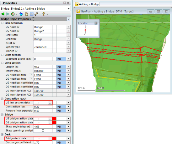

GeoPlan Tools toolbar and then click on the bridge on the GeoPlan.
- The bridge property sheet is displayed and the US link section data, US bridge section data, DS bridge section data, Bridge deck data, and the DS link section data sections contain the corresponding data.
- As can be seen from the screenshot above, some red validation errors are being highlighted in the property sheet. We will deal with these very soon.

- The Output window shows that three of the above mentioned sections have validation errors against them:
- As can be seen on the above screenshot, the Bridge property sheet shows that each of these sections is currently missing data (see red on-the-fly validation errors in the property sheet).
