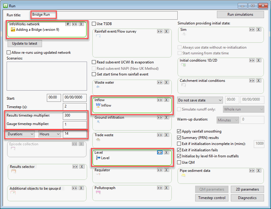

- Create a new run and define the run parameters as shown below:
- In the Explorer window, right-click on the Model Group tree item and select New InfoWorks | Run to create a new run. The Schedule Hydraulic Run View dialog is displayed.
- In the the
Schedule Hydraulic Run View dialog:
- Enter a name in the Run title (Bridge Run)
- Drag and drop your network (Adding a bridge or Adding a bridge- step 4 completed) in the InfoWorks Network drop target.
- Drag and drop the
Inflow hydrograph (set up in the
River tutorial) in the
Inflow drop target.
- If you have completed the River tutorial, both the Inflow and Level hydrograph will be available to pick in your database tree view in the Explorer window.
- If not, they can be copied from the provided transportable database. Open the transportable database by selecting File | Open | Open transportable database.
- In the new
Explorer window that gets displayed with the contents of the transportable database, click on the
button to expand the Model Group.
- Right-click the Inflow hydrograph and select Copy from the popup menu.
- In the Explorer window of your current database, right-click on your Model Group tree item and select Paste: Inflow (with children).
- The Inflow hydrograph is copied in your database.
- Drag and drop the Level hydrograph (set up in the River tutorial) in the Level drop target. Please refer to the bullet point above for instructions on how to copy this hydrograph object from the provided transportable database in case you have not gone through the River tutorial.
- Set the Timestep to 1 second and the Results timestep multiplier to 300.
- Set the Simulation time as 14 hours.
- Use all other suggested defaults throughout.
- Click Run simulations.
- In the Schedule Job(s) dialog, choose which computer will carry out the simulation (This Computer) and leave the other parameters as they are (store results locally and start the simulation now). Click OK to start.
