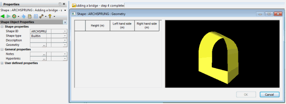

- To view the bridge opening:
- Click on the
Properties Tool (
) from the
GeoPlan Tools toolbar and then click on the bridge opening on the GeoPlan.
- In the bridge opening property sheet, click on the small arrow adjacent to Shape ID and select Open shape ARCHSPRUNG. The "Archsprung" shape property sheet is displayed.
- Click on the
button adjacent to
Geometry.
- The Shape dialog is displayed.
- Close the Shape dialog by clicking on the
button.
- Click on the
Properties Tool (

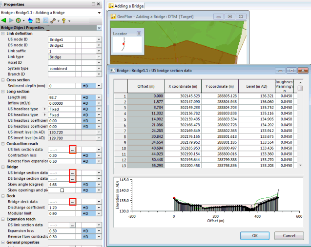

- The completed bridge can also be viewed:
- Click on the
Properties Tool (
) from the
GeoPlan Tools toolbar and then click on the bridge on the GeoPlan.
- The bridge property sheet is displayed. Click on the
button adjacent to
US link section data,
US bridge section data,
DS bridge section data,
Bridge deck data, or
DS link section data to view the corresponding data.
- Once you have finished looking at the data, either click on the
button or the
OK button to close every dialog.
- Click on the
Properties Tool (

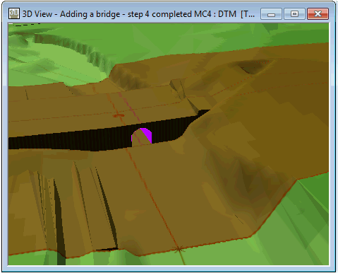

- The bridge can also be viewed in 3D:
- Zoom to the area to be viewed by using the
Zoom in tool (
) of the
GeoPlan Tools toolbar.
- Click on the
3D Network Window tool (
) on the
Windows toolbar to open a 3D window of the bridge.
- Close the 3D view by clicking on the
button.
