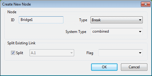

) of the toolbar and add a Break node at the US end of the bridge sections (South) and at the DS end (North).
- In the
Create New Node dialog, use the following parameters and click on
OK. Please ensure that the
Split check box of the
Split Existing Link section is ticked.
Field
US node
DS node
ID
Bridge1 Bridge2 Type
Break
Break
Split existing link
yes
yes
Note: Make sure that the cross hairs are placed exactly where the river reach and the river sections coincide. You may want to zoom onto the areas of interest in order to optimise node location. If the Split check box of the Create New Node dialog is disabled, it means that the node is not located at the intersection between the river reach and the river section.

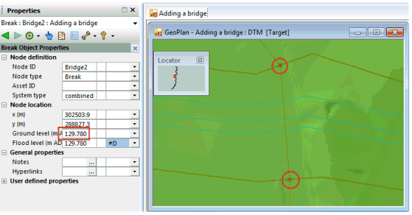

- If you wish set the Bridge1 node ground level to 130.72mAD in the node property sheet and the Bridge2 node ground level to 129.78mAD although break nodes do not necessarily need to have an assigned ground level.

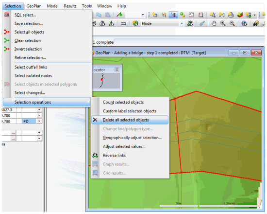

- Delete the short section of river reach between the two new break nodes:
- Select the link between the two nodes Bridge1 and Bridge2 with the
Selection tool (
) that can be found on the
GeoPlan Tools toolbar.
- The short section delimited by the two break nodes is highlighted in red on the GeoPlan.
- Right-hand click on the highlighted section and select Selection | Selection operations | Delete all selected objects.
- The link is deleted from the network.

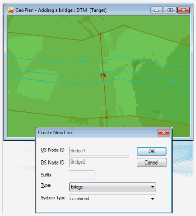

- Draw a new link upstream to downstream (South to North) between the two break nodes ensuring its type is set to
Bridge:
- Set the
New Object type to
link and click on the
New Object tool (
) of the
GeoPlan Tools toolbar and digitise a link from Bridge1 to Bridge2.
- Select Bridge: in the Type dropdown list and click on OK.
Note: It is important to draw the bridge upstream to downstream.

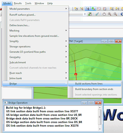

- To build the overall bridge structure from these section lines select the bridge link on the GeoPlan with the
Selection button (
) and then select
Model | Bridge | Build sections from lines. This will generate a report detailing the building of the bridge. Check the details and then close the report window.

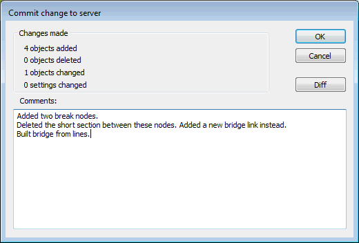

- Commit the changes made to the network:
- In the Explorer window, right-hand click on the Adding a bridge network and select Commit changes to database.
- The Commit change to server dialog is displayed.
- Type in any notes as appropriate.
- Click OK to commit the changes and close the dialog.
- If a message is displayed asking you if you wish to validate the network at the same time as you are committing your changes, click No for now. We are going to validate the network at the next stage.
