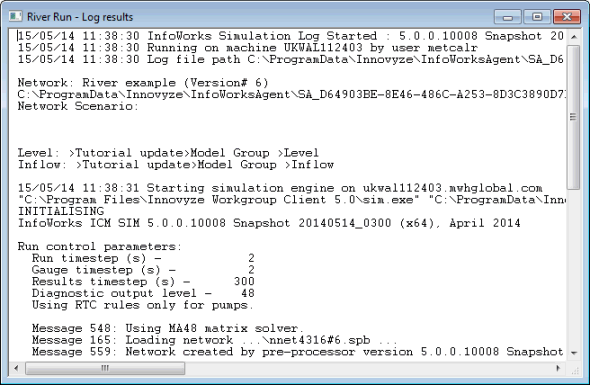

- Select Open As and either select the Log results (text) option or the 'PRN' summary results (text) (the PRN option shows you the raw data) and then click on OK.
- Use the scroll bars to move around the report and check for any messages that indicate that there may have been a problem with the simulation. If there are any problems in the simulation, the data it produces may not be reliable. After checking the log, close the window by clicking on the
button on the top right-hand corner.

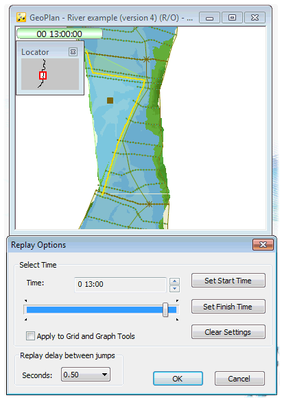

- To view a replay of the simulation:
- Drag the DWF simulation from the Run Group onto the main window. The network is displayed.
- Drag and drop the DTM gridded ground model.
- Use the
Play button (
) of the
Replay Control toolbar to replay the simulation or the
Jump / Replay button (
) to select results for a particular time during the simulation.
- Using the thematic options, you can monitor the effect of the run on a number of network parameters. For example, you can display flood extents on the GeoPlan by customising the Flood theme.

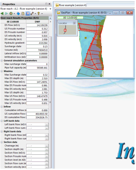

- You can use the
Properties tool (
) to display the properties for a link or node.
- The Object Properties window now show the results for the selected object at the current timestep.
- Use the Jump / Replay button to advance the simulation to a particular time before clicking on the object.

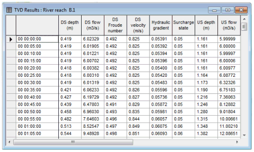

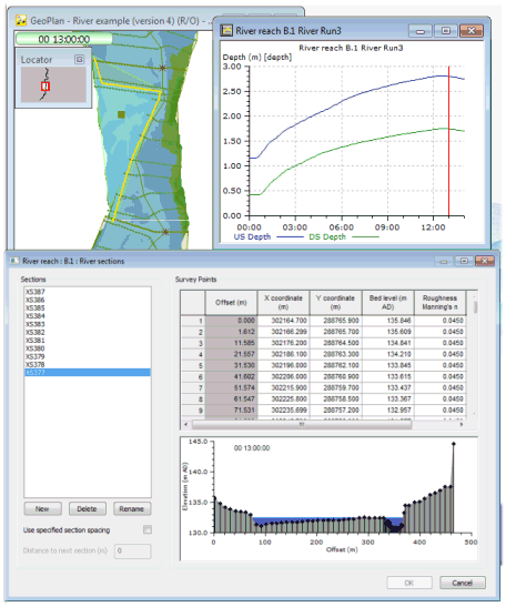

- You can display a graph of the effect of the simulation on various parameters for any point in the network. For example, you can view a graph of the flow through a particular link:
- Click on the
Graph button (
) on the
Results toolbar and then on the B.1 link. A dialog is displayed, listing the parameters that are available.
- Select a parameter from the dialog (Depth in the screenshot below) and click on OK. The graph is displayed and can be resized. The vertical red line shows the current time in the simulation.
- You can then select the river reach in the GeoPlan with the
Properties button (
) and scroll through the sections on the dialog. Every cross section graph shows the water level at the current timestep.
- Click on the
Graph button (
- You can hold down the
CTRL key while clicking on a network object with the
Graph button (
) to display a grid of results for a particular link or node. Alternatively, you can use the
Grid tool (
) and click on the link. Close the grid when you have finished viewing the results.
