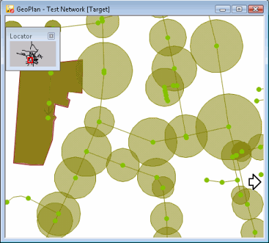

With the option enabled:
- Large arrows appear when you move the cursor close to the edges and corners of the GeoPlan.
- Click with the left mouse button to scroll the view in the direction indicated.
- Click and hold the left mouse button to scroll repeatedly in the direction indicated.
GeoPlan with Automatic Panning Cursor visible on the right
