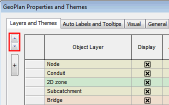

The drawing order is defined by the order of rows on the Layers and Themes Page of the GeoPlan Properties dialog. Object types at the top of the list are drawn last.

  1. Right-click on the GeoPlan Window and choose Properties & Themes.
    The Layers and Themes tab of the GeoPlan Property dialog is displayed.
  2. Select the object types you want to move in the drawing order by clicking the grey numbered cell on the left of the row. You can use the Shift and Ctrl keys to select more than one object. See Editing Data in the Network Object Grid Window for more on selecting rows.
  3. Click (Up ) or (Down ) to move the order of the selected object layers. The higher up the list you go, the later the objects will be drawn. The object type at row 1 will be drawn last, and so will be on top of everything else.
Changing the drawing order of object layers on the Layers and Themes Page (image from InfoWorks ICM)
