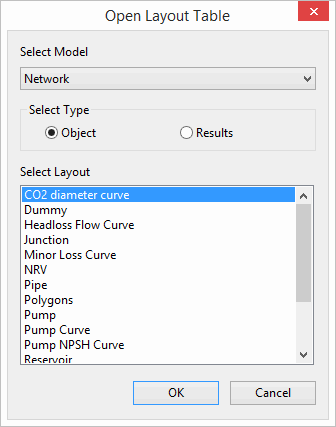

This dialog allows you to display the layout of the Object Properties window for the object type/result of your choice.
The dialog is displayed by clicking the Configuration (Configuration) tool in the Object Properties window and then selecting Layout Open.
Open Layout Table dialog
Item Description
Select Model (dropdown list) Lists the available networks.
Select Type
Object If selected, shows properties layouts for objects in the Select Layout area.
Results If selected, shows properties layouts for results in the Select Layout area.
Select Layout Lists available layouts for either objects or results, as chosen in the Select Type area.
OK (button) Closes this dialog and displays the selected properties layout on the Object Properties window.
