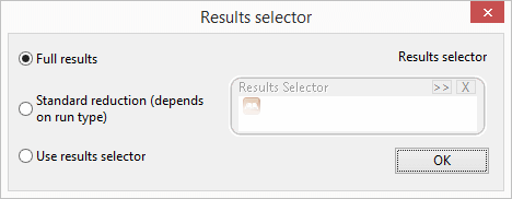

Results Selector dialog
The dialog is used to select whether full results or a subset of results are generated for a run.
The dialog is displayed by selecting the Results selector button on the Schedule Hydraulic Run view.
Show image
dialog item Description
Full results
This is the default option. This option will generate the full results for a run.
Standard reduction (depends on run type)
This is applicable for Normal and Critical Link Analysis (CLA) runs.
This option will generate a subset of results for a run. The subset has been predetermined for specific types of run and cannot be customised by the user. For more information about the subset of results included when this option is selected, refer to results for Normal and CLA runs.
Use results selector This option will make the controls in the Results selector area available.
Results Selector
This feature lets you use a predetermined results subset. The results subset is specified in a results selector item.
To use this feature, there must already be a results selector group containing a results selector item in the model group.
Drag the required results selector item into this box, or use the browse button Browse to select one. You can remove the item from this box by clicking the delete selection button Delete Selection.
Results included in Standard reduction for Normal run
The standard reduction for Normal runs gives the result attributes listed in the feature (except that node-status is not available for fixed head). The result file size is reduced by 50% compared to the full result set.
