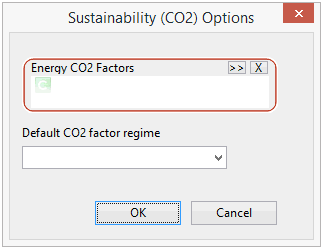

The Sustainability Options dialog is used to set sustainability calculation options when the Sustainability (CO2) option is checked in the Schedule Hydraulic Run View.
Show image
Option Description
Energy CO2 Factors
Energy CO2 Factors Data item.
Default CO2 factor regime
Select a CO2 factor regime present in the Energy CO2 Factors Data item above. This regime will be used to calculate network energy losses as a CO2 equivalent and as a default for any pumping station that does not already have a regime specified.
