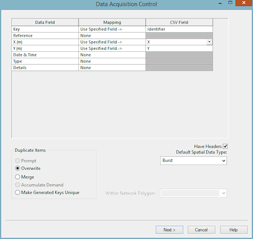

The Acquisition Page of the Spatial Data Analysis Wizard is only displayed when importing new spatial data points.
On the Acquisition Page fields in the import data are mapped to the data fields in the InfoWorks Database. If importing a CSV file, you need to know the structure of the CSV data in advance.
Datafield Mapping Grid
Map fields in the import data to the data fields in the InfoWorks Database.
Data Field
Read only column of InfoWorks Database fields.
Mapping
Mapping between Data Fields and CSV / GIS Fields
CSV Field / GIS Field
Field from CSV / GIS file to be imported.
See below for more details on Mapping fields from CSV and GIS files.

Default Spatial Data Type
Set a default value for the Type field. If the field in the imported data is blank, or an imported data field has not been mapped on to the Type field, then the default value will be used. Select an option in the Default Spatial Data Type dropdown list, or type in a value.
Within Network Polygon
Acquire data only within selected network polygon. Useful to limit the geographical area from which spatial data is associated. This can filter out data that may be in the file but does not apply to the current model.
Mapping Grid
CSV Data
In the right hand column, put the index number of the CSV field that you want to import into the object field in the left hand column. The index numbers for the CSV data begin with 1.
For every field that has a numeric entry in the right hand column, you must change the entry in the Mapping column from None to Use Specified Field->. These are the only two options available for mapping.
GIS Data
In the Mapping column there are several options available. You can:
  • map individual fields to specific fields in the GIS data by using the Use Specified Field-> option. You then select the GIS field name from the dropdown list in the GIS Field column
  • choose Use Key Field for the Key field to automatically link the Key to the primary key in the GIS file
  • choose Use Feature Centre X/Y for the X and Y fields to automatically link these to the GIS position data
  • select None if you do not want to map data for this field
Required Data
The only fields in the import file that must have data in them are the Key, X, and Y fields. The Key field must uniquely identify the Spatial Data object within the database. Therefore, if you import more than one file of Spatial Data, it is not enough for the key to be unique just within the current file.
You can, if you want, allow InfoWorks to generate a key for you. Simply leave the mapping for the Key as None. InfoWorks creates a key based on the X and Y values in the data file.
