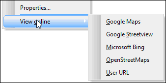

  1. Right-click the location/ object of interest on the GeoPlan, select View online, then choose the desired map service.
    If several objects are selected on the GeoPlan, only the GPS coordinates of the last object will be used by the online mapping service.
    Online map availability on the GeoPlan context menu is configured in the Online Map Options dialog. Supported types include:
    • Google™Maps
    • Google™ Street View
    • Microsoft™ Bing
    • OpenStreetMap
    • User-defined URL
  2. GeoPlan context menu

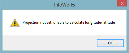

  3. If no coordinate system has been set, a warning message will be displayed. In this case, click OK on the message, set an alternative coordinate system, then restart the procedure from step 1.
  4. Tip: For MapX map controls, and if no map control has been specified, it is essential to manually set a coordinate system to be able to use web mapping software.
    Projection not set message

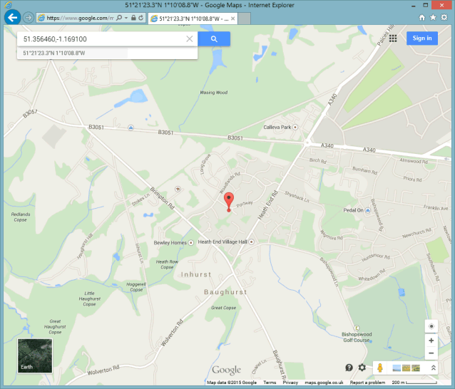

If no warning message similar to the one described above is displayed, the selected web mapping software is opened using the default browser. The map opens with the location/object corresponding to the GPS coordinates that have been clicked on the GeoPlan highlighted on the map. By default, the map will be centred on these coordinates.
GoogleMaps example
GoogleMaps

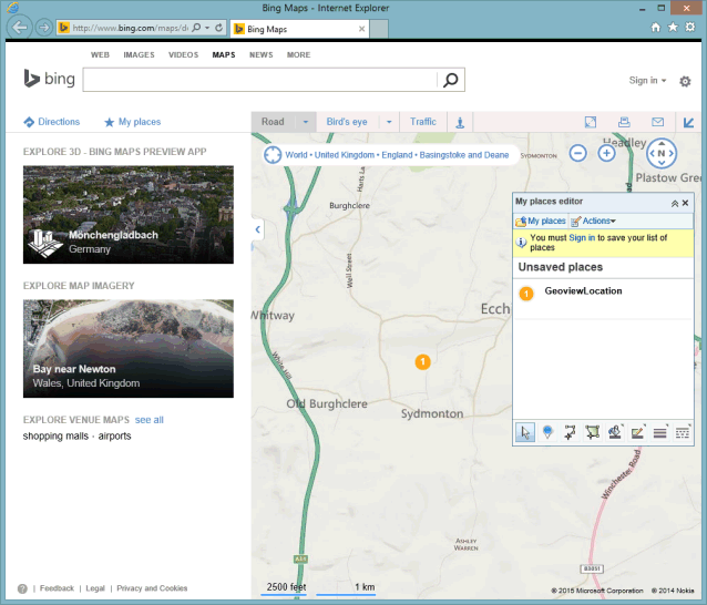

Microsoft Bing example
Microsoft Bing
