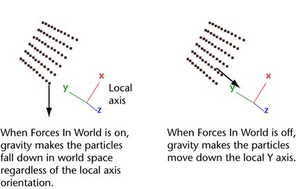

- Forces In World
If you prefer that a field affect a particle object in its local space, select the particles, display the Attribute Editor, and turn off Forces In World.
Note that the orientation of the local axes of a particle object matches the orientation of the world space axes unless you rotate the object.
Tip:If you have not keyed, parented, or otherwise controlled the transform attributes of a particle object, you can turn off Forces In World to speed up dynamic calculations for the object. When Forces In World is on, Maya does extra computations to convert world space to local space coordinates.
