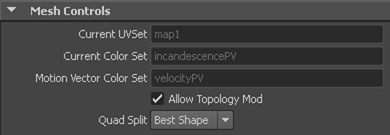

  5. In the Attribute Editor, click the polySurfaceShape tab.
  6. In the Mesh Component Display section, turn on Display Colors.
    Your nParticle output mesh should now display the colors defined by the selected color set. In the Mesh Control section, the Current Color Set attribute should be set the selected per-vertex data set.
