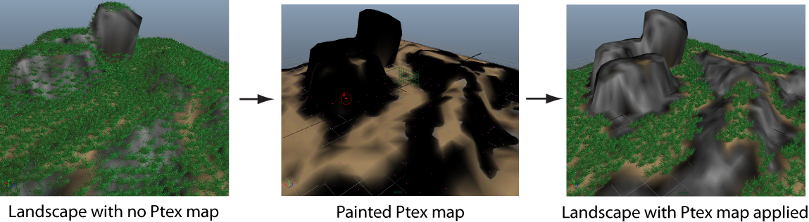

In the landscape scene, a number of grass clumps appear on the top of the rocky outcrops. You can paint a Ptex-based Density Mask so that no grass clumps generate on these areas.

in the Tool Box to open it. - Use the 3D Paint Tool to paint the areas of the mesh where you do not want to generate grass clumps.
- Click this
icon to save the Ptex map. - Preview the Description.
Grass clumps no longer generate on the rocky areas of the landscape.
