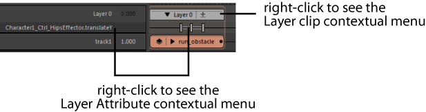

Clip Layer attribute contextual menu
To open Clip Layer attribute contextual menu
  • Right-click the Clip Layer attributes of a Time Editor Clip Layer in the Roster.
  • Note: Clip Layers have two different contextual menus, depending on whether you right-click the Layer track in the Roster side of the Time Editor or the Time View area.
