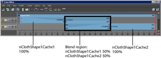

nCache clips are blended automatically. By default, all the overlapping regions of your enabled nCache clips are automatically blended together using their cache clip’s current weight settings. See Input Weights.
nCache weights are normalized between overlapping cache clips. So if two overlapping cache clips have the same weight values (i.e. 1.0 and 1.0, 0.5 and 0.5 and so on), then they will both equally contribute to the simulation in their cache blend regions on playback.
You can adjust the smoothness of your cache clips’ blends by adjusting their weight settings, or by manipulating their weight curves. For example, if you have two overlapping cache clips, one from frames 0-200 and the other from frames 100-300, and both their Input Weights are set to 0.5 (50%), then both cache clips equally contribute to their object’s deformations from frames 100-200 during playback.

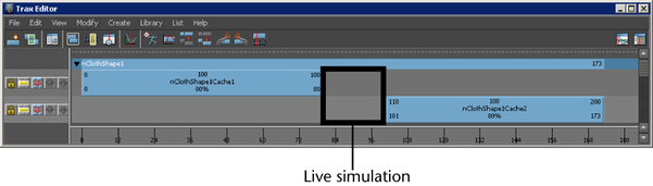

Sequential cache clips are not blended. When there are gaps between your nCache clips, they are filled with the live playback of your object’s original (source) simulation—not interpolated cache data.

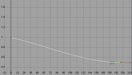

You can create weight curves for your nCache clips. These weight curves let you adjust how your nCache clip’s simulation ease in and out of their blend regions.
To create and adjust nCache clip weight curves
  1. In the scene view, select the object whose cache clip weight curves you want to create and adjust.
  2. In the Trax Editor, select List > Load Selected Characters.
    All the current object’s caches appear as clips in the track view.
  3. Select the nCache clip whose weight curve you want to create and adjust.
  4. Right-click the cache clip and select Create Weight Curve from the context-sensitive menu that appears.
    A weight curve is created for the selected cache clip.
  5. Do one of the following:
    • In the Trax toolbar, click the Graph Weight Curves button ().
    • Right-click the selected cache clip and select Graph Weight from the context-sensitive menu that appears.
    The Graph Editor opens with the selected cache clip’s weight curve framed in its graph view.

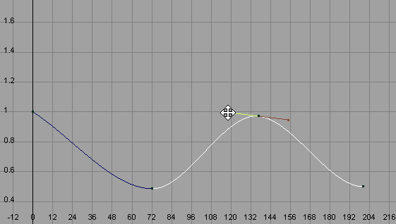

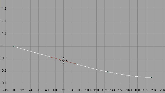

  6. Adjust the shape of your cache clip’s weight curve by doing the following:
    • Move the weight curve’s keys or key tangents.
    Select the Move Tool from the Maya toolbox, and middle-drag the keys or their tangent handles to change the shape of the weight curve.
    • (Optional) Add new keys to the weight curve.
    Select the Insert Keys Tool () Graph Editor’s toolbar, and middle-click the weight curve to add additional keys to the weight curve.
    You can then use these new keys and their tangent handles to further manipulate the shape of the weight curve.
    The modified weight curve now appears on the selected nCache clip in the track view area.

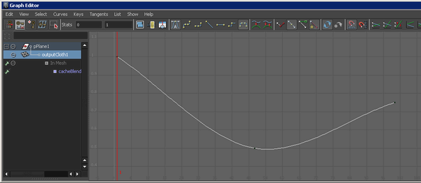

    Tip:
    In the Attribute Editor, you can also key the Input Weight attributes on your object’s caches’ cacheBlend tabs to create nCache weight curves for your objects.
