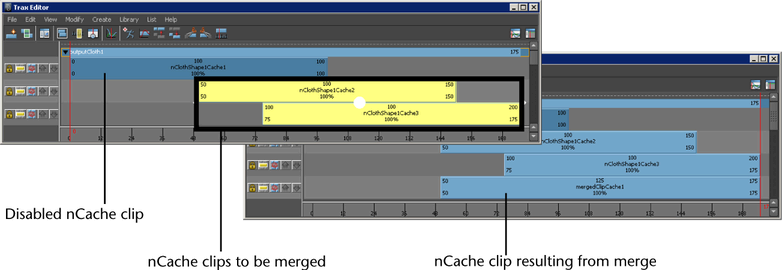

Merge nCache clips
You can merge your nCache clips into a single new cache clip. The cache clips you want to merge can be positioned sequentially in a track or can be located on different tracks. You cannot merge disabled nCache clips.
You can only merge nCache clips if each of the cache clips that are located in the merge time range are selected or disabled. For example, if you have cache clip 1 (frames 1-100), cache clip 2 (frames 50-150), and cache clip 3 (frames 100-200), and you want to merge cache clips 2 and 3, then cache clip 1 must be disabled or selected for the merge.

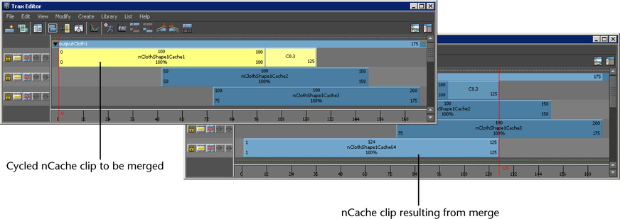

To merge a single nCache clip
- In the scene view, select the object whose cache clips you want to merge.
You can merge individual scaled, cycled, or held nCache clips.
- In the
Trax Editor, select
List > Load Selected Characters.
All the current objects’s caches appear as clips in the track view.
- Enable the nCache clip you want to merge and disable all other cache clips.
- In the
FX menu set, select
The single cache clip you selected merges according to the settings in the Merge nCaches Options window, creating a new ncache clip, cache file, and description file.
The nCache clip you merged is disabled and its associated cache file on disk is not overridden or deleted.

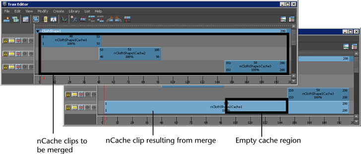

Merge multiple non-overlapping nCache clips
You can merge non-overlapping nCache clips.
However, if there are gaps between the non-overlapping nCache clips you want to merge, then the gaps are linearly interpolated and no cache data for those gaps is saved to the merged cache clip.
For example, you have three cache clips that you want to merge: cache clip 1 (frames 1-50), cache clip 2 (frames 50-100), and cache clip 3 (frames 150-200). When you merge these cache clips, the length of the resulting merged cache clip will be frames 1-200, but frames 101-149 will contain no cache data.
To merge multiple non-overlapping nCache clips
- In the
Trax Editor, select
All the current object’s caches appear as clips in the track view.
- Enable the non-overlapping nCache clips you want to merge and disable all other cache clips.
- Select the non-overlapping cache clips you want to merge.
- In the Trax menu bar, select
Edit > Merge Cache Clips.
All selected non-overlapping nCaches merge according to the settings in the Merge Cache Clip Options window, creating a new nCache clip, cache file, and description file. See Trax Editor Edit menu.
The nCache clips you merged are disabled and their associated cache files on disk are not overridden or deleted.

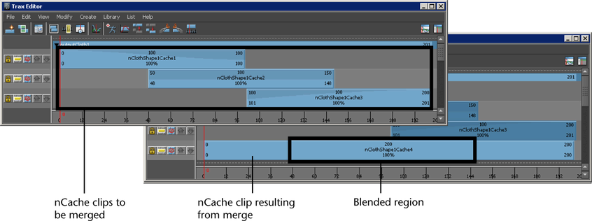

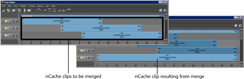

Merge multiple overlapping nCache clips
You can merge multiple overlapping nCache clips. The regions of the cache clips that overlap are blended according to their current Input Weight settings and any of their weight maps.
See Blend nCaches and cacheBlend node.
To merge multiple overlapping nCache clips
- In the
Trax Editor, select
- Enable the overlapping nCache clips you want to merge and disable all other cache clips.
- Select the overlapping cache clips you want to merge.
All the selected overlapping cache clips merge according to the settings in the Merge Cache Clip Options window, creating a new nCache clip, cache file, and description file.
The nCaches you merged are disabled and their associated cache files on disk are not overridden or deleted.
