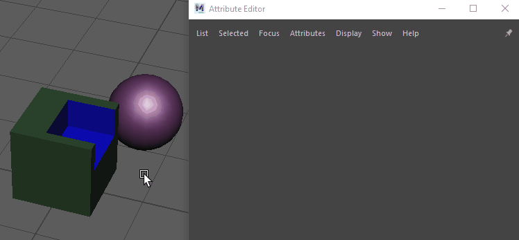

  • With a boolean object selected, open the Attribute Editor and select the polyBoolean node.
You can edit the objects you combine in a boolean operation using the Boolean stack.
Task Description
Pin the boolean stack
Click to pin the Boolean stack, keeping it visible even when you change selection in your scene.

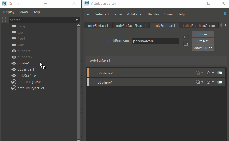

Add new objects to the stack from the Outliner
Middle-drag objects from the Outliner to an empty space in the Boolean stack.
Note: Before you add objects, do one of the following in the Attribute Editor:
  • Click to pin the Boolean stack.
  • Click Copy Tab to open the node in a separate window.

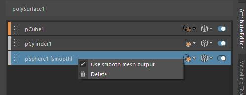

Turn on smooth mesh for input objects
Right-click a layer and select Use smooth mesh output to connect the input object's Out Smooth Mesh to the boolean node's Input Poly. This lets you see your input objects as caged representations, while still viewing the boolean output as a fully smoothed representation. (smooth) is appended to the input object name, indicating the selected input object's smooth mesh is being used. If an input object has Smooth Mesh Preview turned on when a boolean operation is performed, it's Out Smooth Mesh is automatically connected and Use smooth mesh output is turned on.
