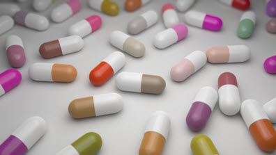

  • Render the scene. It should look like this:

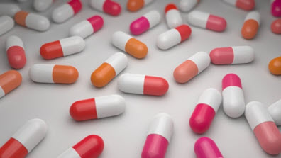

  • If we change the rand values to the following:
 $a=[1,rand(0,0.5,$id+1),rand(0,0.5,$id+2)];#-1.0,1.0
 $a
...we get something that has RGB values, but it has more of a red color and less green and blue.

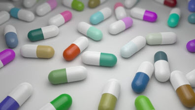

 $a=[rand(0.5,1,$id),rand(0,0.8,$id+1),rand(0,0.8,$id+2)];#-1.0,1.0
 $a
...the pills have more variety of colors because the red color value is between 0.5 and 1.
