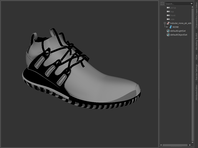

Import the shoe model: tubular nova pk ads.IGS (Z-axis).
Position and orient it so that it sits at the center of the scene grid.
.STEP shoe model imported in Maya

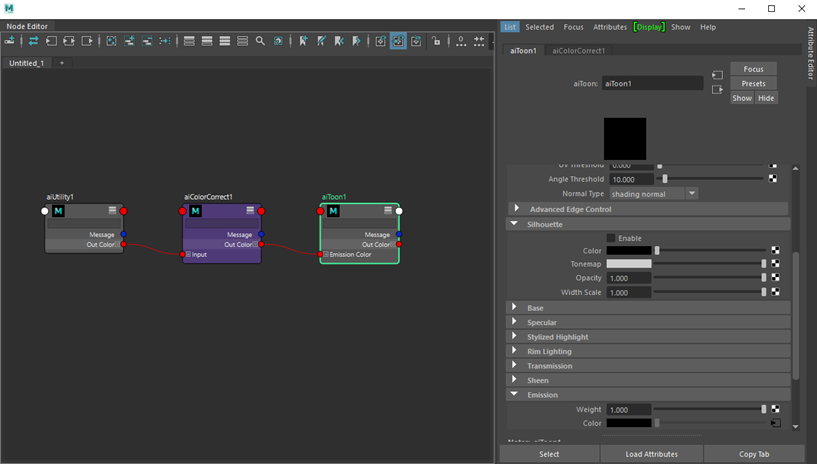

Under edge_detection, reduce the angle_threshold from 180 to around 10. This will show more detailed edges in the sole of the shoe.
Create a Utility shader and connect it to the emission_color of the toon shader. Increase the emission_weight to 1.
Change the Utility Color Mode to obj and the Shade Mode to ndoteye. This will give us some interesting colors with a flat cartoon style shading.
Use a color_correct shader to refine the hue, saturation, etc values of the color shading effect given by the Utility shader.
To view the toon_edge, you must change the filter_type (sampling settings) to contour. Note that increasing the contour_filter_width (sampling settings) value will increase render times. If it appears too thick try reducing it to 1.
Render Settings: Arnold > Arnold Renderer tab > Filtering > Type: Contour
utility -> color_correct -> toon

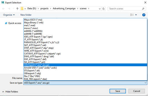

We now want to export the finished sneaker geometry as a .ass file. This will allow us to use procedurals which will keep our scene light and responsive.
- Select the sneaker geometry and go to File > Export Selection. Choose where you want to save the .ass file. It will ask you what you want to export.
Export to Arnold Scene Source (.ass) using the default export

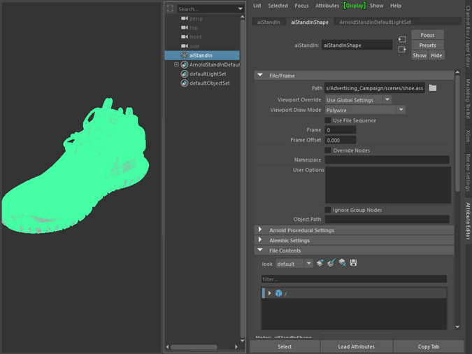

Next, we want to create an Arnold stand-in within which we can import the . ass file that we exported earlier. Stand-ins allow you to keep your scene light and workable by deferring the loading of geometry data until render time. This will be useful when we create multiple instances.
Create a new scene.
Go to Arnold -> Standin.
Select the Path folder ... in the stand-in and choose the .ass file that we exported earlier.
shoe .ass file loaded in stand-in. Viewport Draw Mode: Polywire.

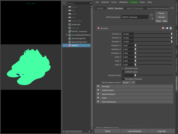

- Select the Arnold procedural and create a MASH network.
- Select the Distribute node and enable Center Distribution.
- Select the MASH waiter and create a Random node. Increase the Position X, Y, Z to 10.
