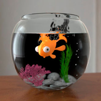

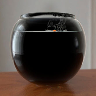

The scene below contains many glass surfaces. Increasing the transmission_depth reveals more detail in the refracted glass.
| 2 | 4 | 6 |

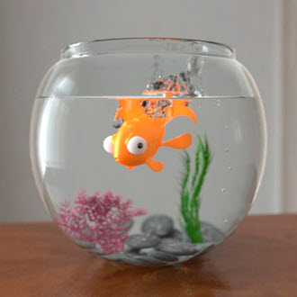

Final Render
Here is the final image. The transmission_depth has been left at the default value of 8. Higher values may be required to reduce further areas in the splashed water where the render appears solid black.
