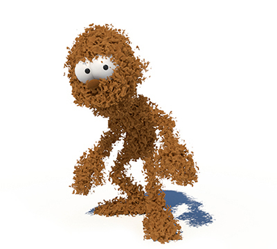

noise -> standard_volume.displacement. step_size: 0.1, volume_padding: 0.05.
- When the step_size is positive, it turns a polymesh into a volume and its value is used as the base step for raymarching the volume.
The mesh should be closed and not have anything self-intersecting, otherwise, the volume may not render correctly.
Note:
Pepe model by Daniel M. Lara (Pepeland)
