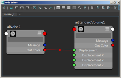

Create a standard_volume shader and a noise shader. Connect the noise shader to the displacement attribute of the standard_volume shader. You may need to increase the density to see the bunny volume.
Noise -> standard_volume.displacement

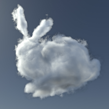

Noise Type Examples
The images below show the effect of using different noise types connected to the standard_volume.displacement.
| Arnold noise | Cell noise | Perlin noise |
