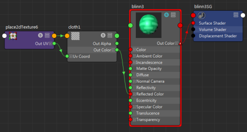

Gives the surface the ability to reflect its surroundings (the environment, other surfaces) or the Reflected Color, when viewed at oblique angles. The slider range is 0 to 1. The default value is 0.7.
To help visualize the effect of Specular Roll Off in a Blinn material swatch, assign a texture to the Reflected Color.
