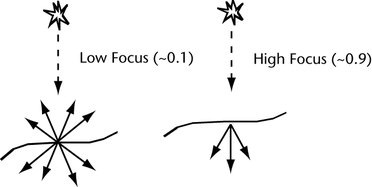

Translucence Focus
The Translucence Focus value controls how much translucent light is scattered depending on the direction of the light.
For example, use a high value for very thin materials, such as wax paper or steam, where most of the light is scattered over a small angle relative to the light’s direction. The object looks brightest with the light source directly behind it.
Note:
When a spotlight is used to light an object with a translucent material, the light does not scatter past the light's cone of influence, even if Translucence Focus is lowered.
Use a mid-range focus value for items such as leaves. The leaves glow when backlit, but do not wash out when lit from the front.
Use a low focus value for thicker objects, such as wax. To compensate for the added light and avoid a washed out result, lower the diffuse value, or lower the overall color (which also affects ambient lighting).
