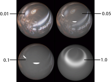

- Roughness
Determines the overall roughness of the surface. The range is 0.01 to 1.0. The default is 0.7. Smaller values correspond to smoother surfaces and the specular highlights are more concentrated. Larger values correspond to rougher surfaces and the specular highlights are more spread out—similar to being diffused.

- Anisotropic Reflectivity
If on, Maya automatically calculates Reflectivity as a fraction of Roughness. Reflectivity is on by default.
If off, Maya uses the specified Reflectivity value for the environment map (mapped on the Reflected Color attribute), similar to how the Phong and Blinn materials work.
In the following, Anisotropic Reflectivity is on, an environment is mapped on the Reflected Color, and the Roughness is set to 0.01, 0.05, 0.1, and 1.0 (from very smooth to very rough).
