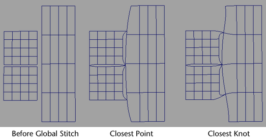

Stitch Corners
The Stitch Corners options specify where a surface corner is stitched to an adjacent corner or surface edge. Regardless of which option you choose, stitching occurs only if the points are within the Max Separation distance.
Stitching occurs at a point between two corners or between a corner and a point on the surface edge. Where a corner would stitch to a point on an edge rather than a corner, the following options are available.
Closest Point
stitches a corner to the closest point on the edge.
Closest Knot
stitches a corner to the closest knot on the edge.
Off
does no explicit corner stitching.

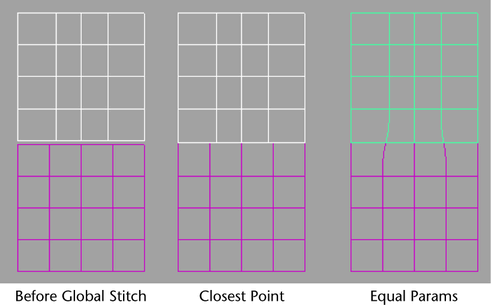

Stitch Edges
The Stitch Edges options specify where adjacent edges are stitched together. Regardless of which option you choose, stitching occurs only if the edges are within the Max Separation distance. Stitching occurs along the midpoint between the edges.
Closest Point
stitches the closest points on the edges while ignoring parameterization differences between the edges. Because the number of patches may differ, an exact join might not occur.
Match Params
stitches points on the surface edges that have equivalent UV increments along each edge. The number of spans is ignored. To achieve the best possible fit with this type of stitching, make sure the two edges have the same UV values, the same number of spans, and lined-up knots.
Off
does no explicit edge stitching. If you turn on one of the Stitch Corners options (other than Off) and set Stitch Edges to Off, the corners will be stitched together, but not the edges.

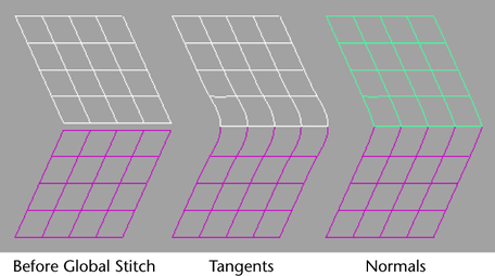

Stitch Smoothness
Select the way that the joined isoparms appear.
Tangents
bends isoparms so they are perpendicular where they meet the stitched edge. This yields the best continuity between the surfaces.
Normals
does not require the isoparms to be perpendicular, though the surfaces still join smoothly.
Off
turns off smoothing and doesn’t ensure tangency of the edge regions.

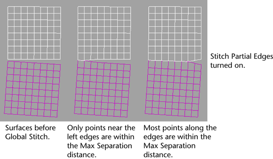

Stitch Partial Edges
If this option is on, Maya joins any parts of an edge pair that are within the Max Separation distance. The same pair of edges may therefore join and separate a number of times along their length. If this option is off, no part of the edge pair will be stitched if any points along the edges exceed the Max Separation distance.
Do not turn on Stitch Partial Edges when unnecessary. This option takes extra processing time.
