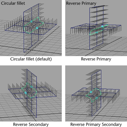

- Reverse Surface Normals
During the fillet construction, the surfaces are offset in the direction of the normals by the Radius value you specify. By reversing the surface normals, you can construct the desired fillet. Click the Show Manipulator icon to see the surface normals.
Before you create the fillet, choose to reverse either the primary surface normal (the first selected surface), or the second surface normal (the second selected surface). The following examples show both primary and secondary reverse methods with a radius value of 0.75.
You can also reverse surface normals by selecting points on the surfaces and constructing the fillet. For example, the normals on the secondary surface are reversed if the point selected on the primary surface does not lie on the same side as its surface normal.
To reverse surface normals by selecting surface points:
- Select a point then Shift-select another point.
- Select either Reverse Primary Surface Normal or Reverse Secondary Surface Normal, then click the Fillet button. Click the Show Manipulator icon to see the surface normals.

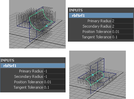

Editing the circular fillet normals using manipulators
- To display the surface normals and radius manipulator after you create the fillet, select the fillet surface and display the Show Manipulator Tool.
- Drag a radius manipulator handle.
