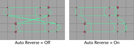

- Auto Reverse
If Auto Reverse is off, the curves are used as they are, which may result in a twisted surface. If on, the curves are automatically reversed.
In the following example, the two top curves and the two bottom curves are going in different directions.
If Auto Reverse is off, the result is a twisted lofted surface. If on, the curves are automatically reversed.

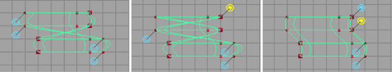

If Auto Reverse is off, you can use the Show Manipulator Tool to reverse the curve direction of the original profile curves as needed. Simply click the manipulator handle to reverse the curve direction.

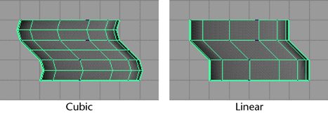

- Surface Degree
You can set the Surface Degree to either Linear or Cubic. This sets the lofted surface to linear or cubic in the U direction. Linear creates surfaces that appear faceted. Cubic creates smooth surfaces.

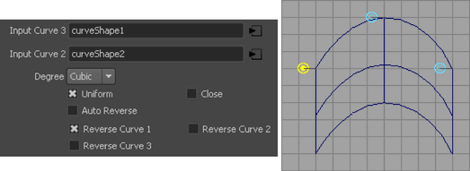

- Reverse Curve
If you turned Auto Reverse off when you lofted the surface, a Reverse Curve option is displayed for each curve, primitive, or surface isoparm you used to create the lofted surface. Select the Show Manipulator Tool to display the reverse manipulators. Click the options to reverse the direction of the input curves, or click the manipulators.
In the following illustration, the first curve used to create the lofted surface is selected for reversal.

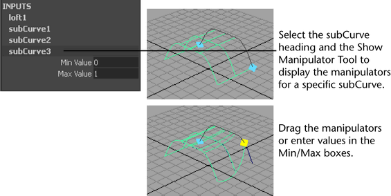

Editing the subCurves in the Attribute Editor
If you set the Curve Range to Partial in the options window when the loft was created, you can use the Attribute Editor for the resulting subCurves.
