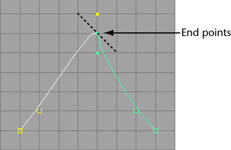

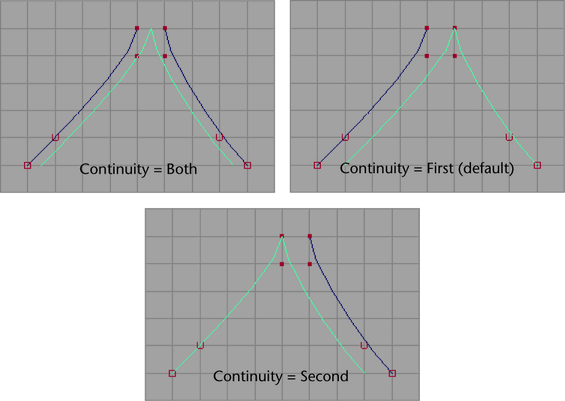

Positional continuity means that the ends of two surfaces meet exactly. The following figure shows a side view of how surfaces are aligned with each Modify Position option (First, Second, and Both). The alignment occurs depending on which surface is selected first (white) and last (green).
Tangent continuity exists when two surfaces are placed end to end, and the tangents at the endpoints also match. An example side view of aligned surfaces follows:

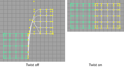

Twist
If Twist is turned on, the second surface is also reversed in the opposite direction of Direction U. Turn this on if your aligned surface is twisted.

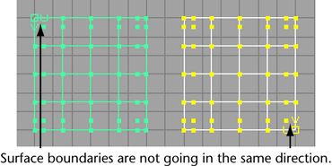

For example, if you align the surfaces and the surface boundaries are going in different directions, the following results.
When you select the surfaces, the align result is twisted. Turn Twist on either from the Attribute Editor or in the Channel Box to correct the problem.

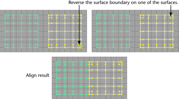

The other alternative is to check the surface U/V direction before you align the surfaces. Use Surfaces > Reverse Direction to reverse the surface directions if necessary.
