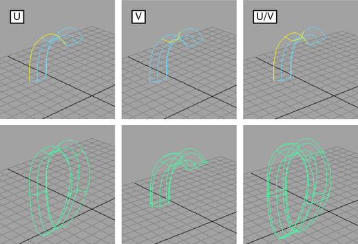

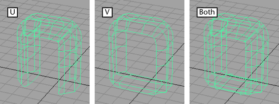

Surface Direction
The Surface Direction options, U, V, and Both, let you choose the direction in which a surface is open or periodic. The following figure shows how these options are used to close a beveled curve.
