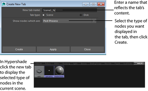

To create a new tab in Hypershade Browser
- Select Tabs > Create New Tab.
- Enter the name of the new tab. This name appears on the new tab in the
Browser.
Tip:
Use names that indicate the content of the tab.
- Select a
Tab Type and specify the corresponding options:
- Scene
Displays a collection of nodes in the current scene. When you select this tab, you must specify an option from the Show Nodes Which Are drop-down list.

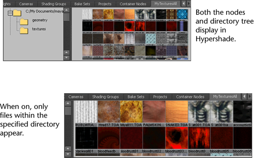

- Disk
Displays files and/or directories on disk. When you select this tab type, the Create New Tab window expands to display the Root Directory option.
- Show Nodes Which Are
For Scene tabs, select to display only certain node types within a specified tab.
- Root Directory
For Disk tabs, either type the path name if you know it, or click the folder icon to browse through directories to select the directory where the items are stored.
- Only Show Files (Hide directory tree)
For Disk tabs, turn this on or off to hide or show the directory tree. This is especially helpful if you find you routinely work with files located in one specific directory. You can switch between viewing directory folders or just the files within that directory.
- Click
Create.
For example, if you want to create a tab that displays only the special effects nodes of the scene, name it appropriately, select Post Process from the list, then click Create. Hypershade displays the Post Process nodes in the scene.
