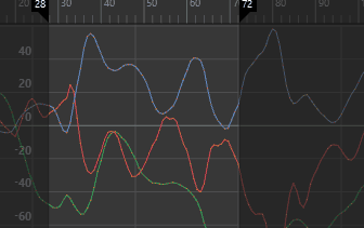

Time Slider
All keys present in the region between the Playback Start and End times in the Time Slider are baked into a new channel.
This setting is the default for both the Graph Editor and Dope Sheet Editor.
Start/End
All keys within the specified time range set in the Start Time and End Time fields are baked into a new channel.
Start Time
Specifies the start of the time range. Available only if Start/End is on.
End Time
Specifies the end of the time range. Available only if Start/End is on.

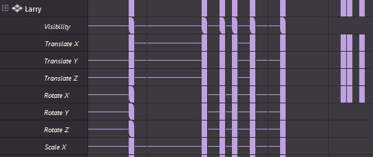

Selection
Bakes the channel selected in the Dope Sheet outliner in a range defined by selected keys.
Note: The Selection option is only available in the Dope Sheet Bake Channel options.
