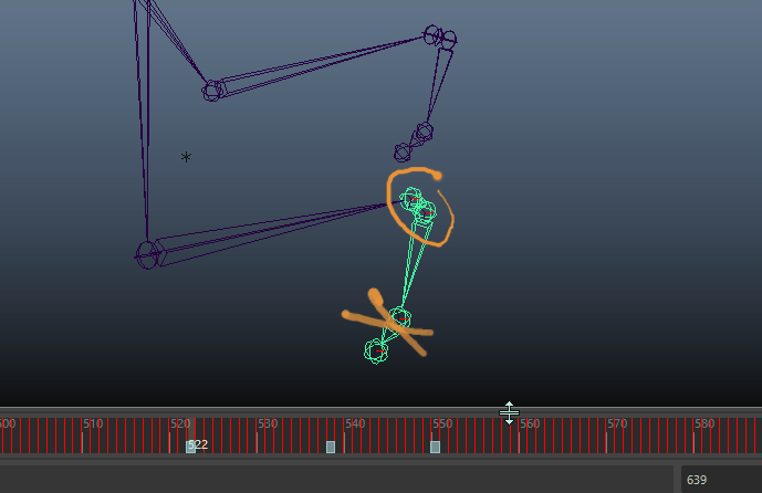

Right-click anywhere on the Time Slider to display a menu for animation control operations.

Tip: You can easily Shift + select and drag keys on the Time Slider to cut and paste them elsewhere on the timeline, and Shift + Ctrl + drag selected keys to copy them elsewhere on the timeline. See Cut Keys and Copy and Paste Keys for more details.
