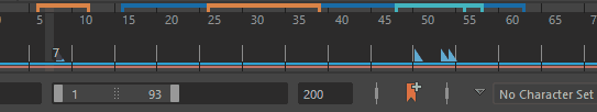

Use Time Slider Bookmarks to flag events on the Time Slider, drawing attention to moments in time for animation or layout, instead of individual keys or animation. Bookmarks are useful in a many different workflows when you work with events in time.
Time Slider Bookmarks consist of a Start and End frame (which can be as small as single frame), a name, and color.

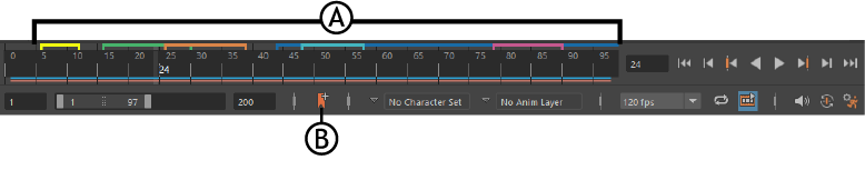

| To... | Do this |
| Create a bookmark | Alt (Option) +
T or click the Bookmark icon
on the
Range Slider to open the
Create Bookmarks window.
| Quick create bookmark | Alt (Option) + Shift + T adds an unnamed bookmark with a random color to the selected frames without opening the Create Bookmarks window. |
