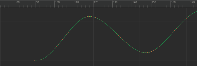

There are two main ways to manipulate curves with retime markers:
To warp the curve
- Select the object with animation you want to retime, then enable the Retime Tool
in the
Graph Editor.
For example, to retime curves for a whole character at once, select the character hierarchy.
- Double-click to create a marker on either side of the segment you want to warp.
When you add multiple retime markers in the graph view, a solid line spans above each pair.
- Drag the thicker middle segment of the markers as follows:
- To slow down animation between markers, drag the markers further apart.
- To speed up animation between markers, drag the markers closer together.
Dragging the individual markers scales the region of animation within the span. The curves in the graph view squash and stretch as you drag. You can also view the adjusted timing of the animated object in the scene view.
