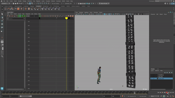

You can use the Graph Editor Sculpting tools to perform intuitive modifications to keys on curve segments using a brush-style tool.
The Curve Sculpting tools used to modify animation (demo courtesy Jim Donovan)

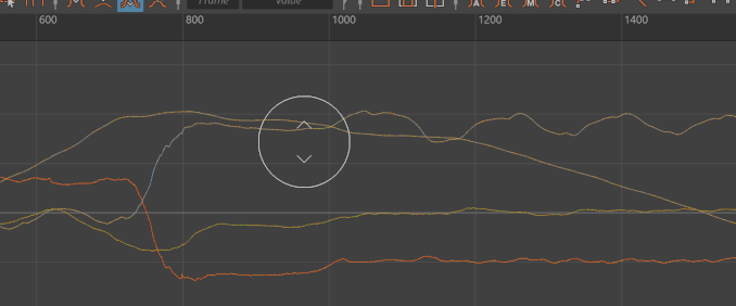

Push keys up or down on a curve (Grab tool)
Select the Graph Editor
Grab tool
and drag over the area of the curve you want to shape key value in the
Graph View.

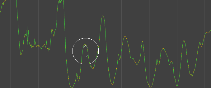

Flatten keys on a curve (Smooth tool)
Smooth tool
and drag over the part of the curve you want to smooth in the
Graph View.
Note: Both the Graph Editor
Smooth and
Smear sculpting tools do not respect value snapping.

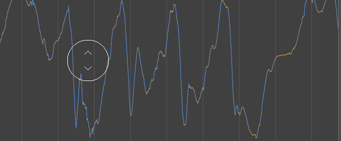

Nudge keys on a curve within a configurable brush radius (Smear tool)
Smear tool
from the
Graph Editor toolbar and drag over the area of the curve you want to influence in the
Graph View.
Smooth and

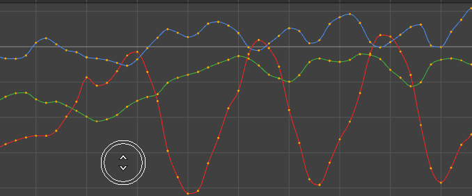

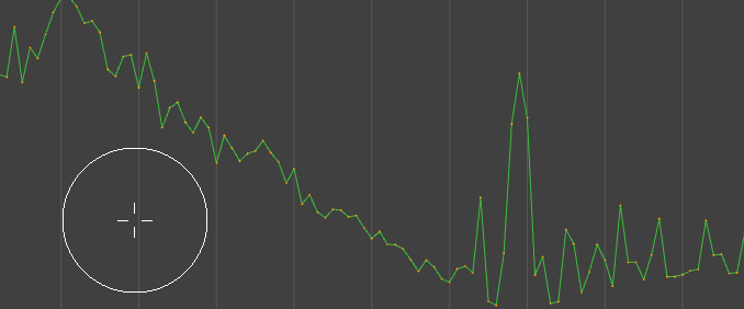

Lessen the number of keys on a densely-keyed curve (Key Reducer tool)
Key Reducer tool tool
and drag over the area of the curve in the
Graph View where you want to reduce the number of keys. Using the
Key Reducer tool lets you simplify densely keyed curves to reduce file size and improve performance.
The
Key Reducer Sculpt tool is similar to the
Graph Editor Curves menu
Key Reducer filter, except as a sculpt tool you can make reductions to specific areas as you go.
Note: The
Key Reducer Sculpt tool does not work on Quaternion Rotation Curves.

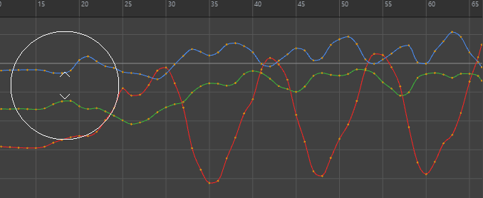

Select curves to sculpt
The Sculpt tool brush radius affects keys, that is, any key
inside the brush circle is changed, unless the key or channel is locked. The selection area is defined by the location where you click the mouse, so clicking in empty areas and then dragging in the
Graph View, changes nothing, even when moving over curves. If more than one curve falls within the brush radius, they are all affected at the same time.

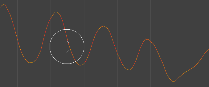

Resize a Graph Editor Sculpt Brush
Middle-drag
left or
right to expand or shrink the size of the Sculpt ring.
Tip: Use
Ctrl + middle-drag to start the brush radius at zero instead of its current size.
Adjusting the size of the Sculpt brush
See
Sculpt Curve tools for more on the tool settings.

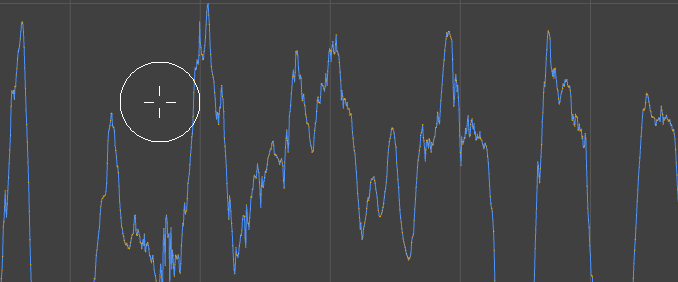

Increase the strength of a Graph Editor Sculpt Brush
Middle-drag
up or
down to change the strength of the action. The Strength indicator inside of the sculpt ring resizes to display the intensity of the tool.
Tip: Use
Ctrl + middle-drag to start the brush strength at zero instead of its current strength.
Adjusting the strength of the Sculpt brush
See
