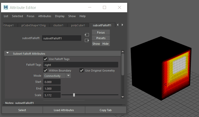

- Within Boundary
- Turn this option on to constrain the falloff effect within or outside the limits of the specified tag.
Toggling the Within Boundary setting on the Right Component Tag of the cube.

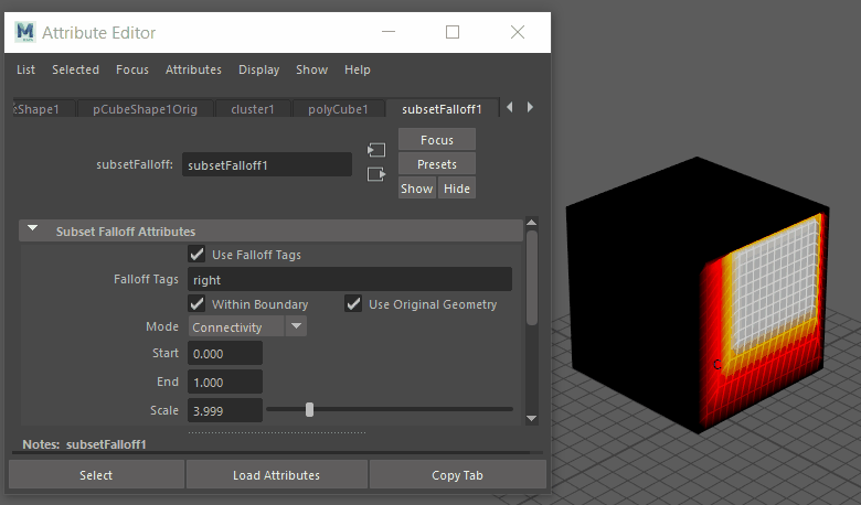

- Multiplies the falloff effect.
Adjusting the Scale setting on the Right Component Tag of the cube.
