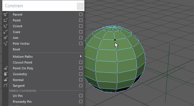

To create a proximityPin node
- Select your geometry.
- Next, select a locator.
- Select
in the
Animation (F4) or
Rigging (F3) menu sets.
A Proximity Pin locator attaches to your geometry at the closest point on the surface from the selected transform.
