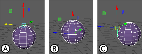

- Relative space mode
Use the menu to set your node evaluation space: World, Local, or Custom. Setting a different relative space
Relative space modes using UVpin and a Locator: A. World B. Local C. Custom
See World space, object space, and local space for descriptions of these spaces.Space Function World (Default) Uses the center of the scene as the origin.
Local Uses the geometry space for evaluation.
Custom Use an external matrix as the space for evaluation.

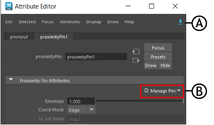

- Manage Pins
Attribute Editor: A. Pin Tab, B. Manage Pins menu
- Use this menu to manage operations you can apply to pin nodes. Choose from the following actions:
Select Geometry Selects the geometry affected by the UV pin. Replace Geometry with Selected Switches the pinned geometry with another selected geometry. Create Pins Creates a new PinOutput node. Select a node (locator/geometry/group, and so on) and the Pin node outputs a pin value, connecting it to the node (depending on the Pin default setting). Edit Pin Defaults Opens the UV Pin window, where you can set new values for the default pins: Existing Transform, New Transform, New Locator, or Matrix. Note: It is recommended to use the Attribute Editor Pin Tab
while using this menu to keep the current attribute tab displayed when the selection changes.
