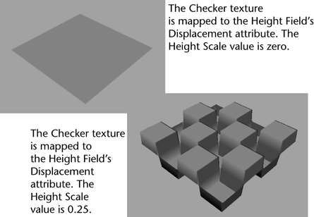

The displacement of the plane. This may be mapped with a 2D texture or an Ocean Shader; however the outAlpha value is always used. This does an optimized evaluation of the texture that ignores added shading engine inputs.
Height Scale
Scale factor for input displacement. As the value increases, the displacement is more pronounced.
