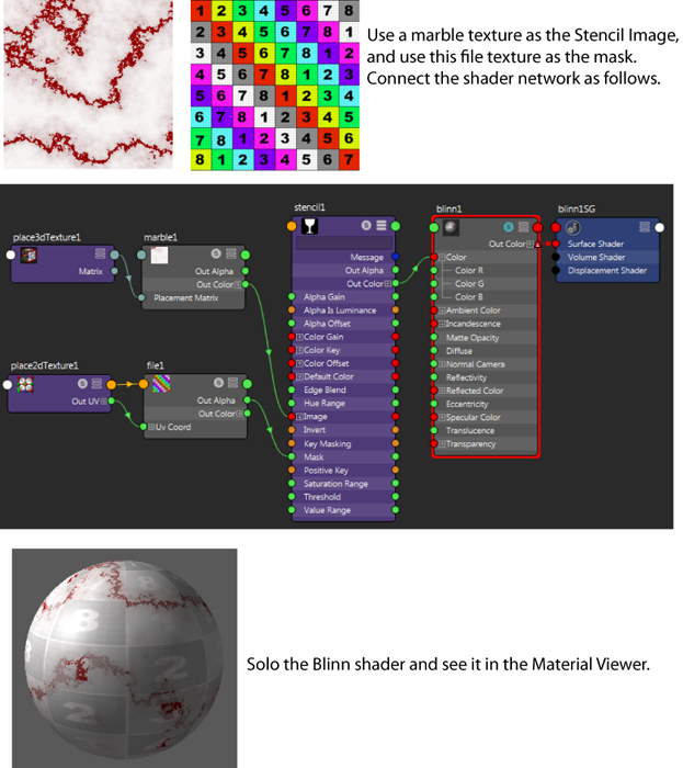

- Mask
Represents the Stencil’s transparency. Use to control the overall transparency of the entire texture. To control the transparency of selected regions of the texture, map another texture to Mask.
For example, this is what happens when you map a File texture to the Mask attribute.
