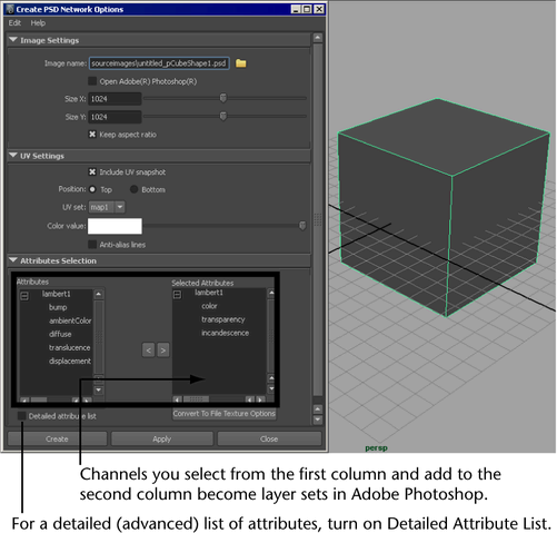

  3. Select Texturing > Create PSD Network.
    The Create PSD Network Options window opens.
  4. Type the name of the Adobe Photoshop file to be created, and set any of the options (or use the default).
  5. In the list of Attributes, double-click an attribute you want to paint to add it to the list of Attributes. Repeat for additional attributes you want to include. If you want to paint an attribute not shown in the list, turn on the Detailed Attribute List.
  6. Select Create.
