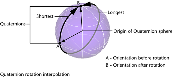

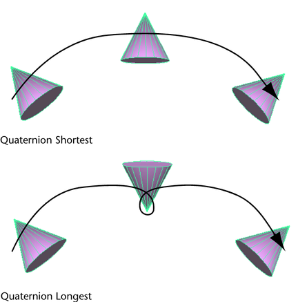

When blending animation clips in the Maya®TraxEditor, you can select one of the following types of Quaternion rotation interpolation: Quaternion Shortest or Quaternion Longest. Quaternion Shortest interpolation uses Quaternion interpolation to find the shortest path between rotations from one clip to the next. Quaternion Longest interpolation uses Quaternion interpolation to find the longest path between rotations from one clip to the next. This path is in the opposite direction of Quaternion Shortest.
You can specify a clip blend’s Quaternion rotation interpolation type from the Attribute Editor by setting the blend’s Rotation Blend attribute.
