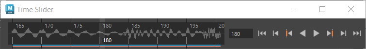

The audio waveform fills the Time Slider

The peaks of the sound waves are visible in the Time Slider, and the Time Slider is ready to play or scrub the sound.
