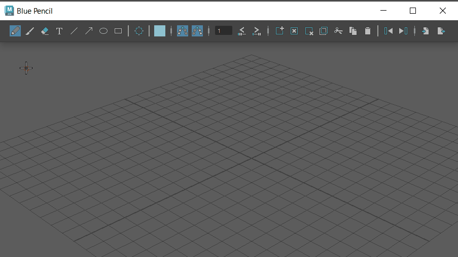

Draw in the Viewport with Blue Pencil:

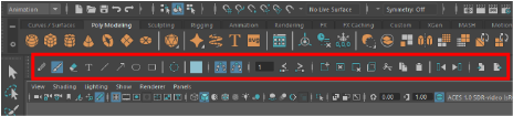

- Open the
Blue Pencil tool by doing one of the following:
- Click the
Blue Pencil icon
in the
Panel toolbar.
- Select from the Animation menu set (F4).
- Click the
Blue Pencil icon
- Choose a tool from the
Blue Pencil Toolbar and start drawing in the Viewport.

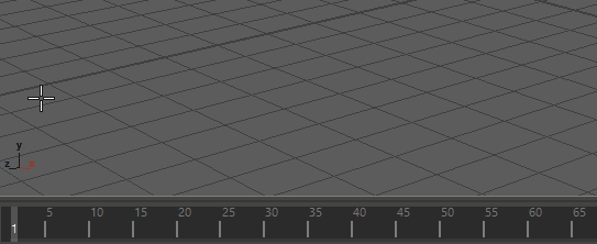

A Blue Pencil frame automatically appears at the position of the Time Slider Current Time Indicator. This frame is considered the Active Blue Pencil frame.
Tip:View Blue Pencil drawings of up to ten preceding or following frames with the Blue Pencil Ghost tool. See Preview Blue Pencil frames with Ghosting.
- To draw a frame at another
point in time, move the current Time Indicator on the
Time Slider to a new position and click the Add Frame icon
on the
Blue Pencil Toolbar. (If you start drawing at a time where no
Blue Pencil frame exists, a frame is created.)
You can Shift + drag to reorganize the order of Blue Pencil frames on the Time Slider. See Work with Blue Pencil frames for more.

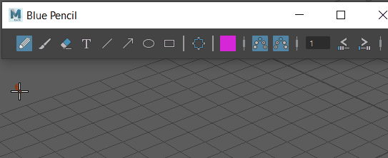

Adjust Blue Pencil Tool attributes:
You can also access Blue Pencil Tool attributes in the Blue Pencil Tool Settings.
