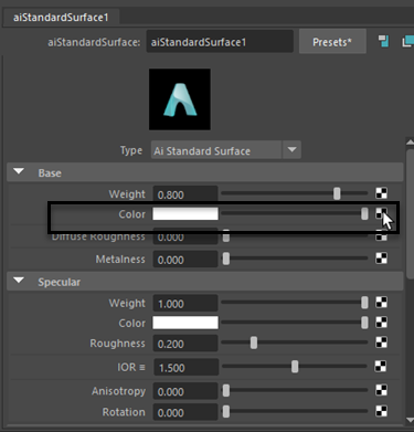

To map a texture to a material using the Attribute Editor or Property Editor
Select your material in the Hypershade. In the material Attribute Editor or Property Editor, click
beside the attribute that you want to connect a texture to; for example,
Color. The
Create Render Node window appears.
- Select File from the Create Render Node window.
In the File node Attribute Editor, map to the image file by clicking the browse
icon beside the
Image Name attribute.
Note: A
icon beside an attribute indicates that it is mapped to a texture.

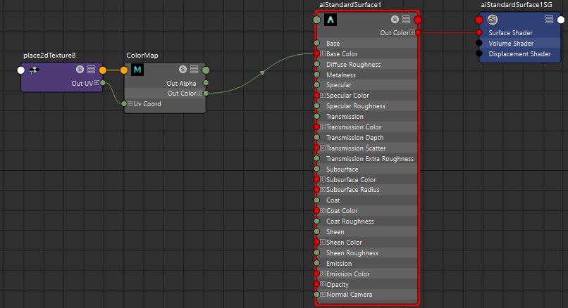

To map a texture to a material in the Hypershade work area
To add a color map to your material
Press Tab and enter the type of your node; in this case, File. For all 2D textures, the mapping method for the texture is indicated beside its name (for example, file [Stencil]).
Alternatively, you can drag and drop the texture from the Create tab into the work area.
In the File node Property Editor, map to the image file by clicking the browse
icon beside the
Note: A
Middle mouse or left mouse-drag to create a connection line between the file node's Out Color attribute and your material's color attribute.

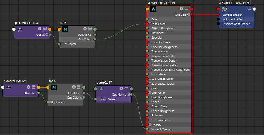

To add a bump map to your material
- Press Tab and create a bump 2d node.
File node, and click the browse
icon beside the
Image Name attribute to map your normal map to the
File texture.
Middle mouse or left mouse-drag to create a connection line between file.outAlpha and bump2d.bumpValue, and from bump2d.outNormal to the Normal Camera attribute of your material.

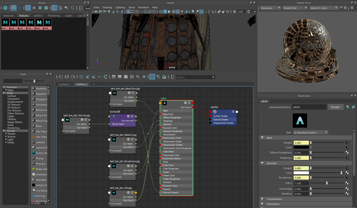

In this example, the metalness of the material is adjusted by connecting the R channel of the file texture's outColor attribute to the material's Metalness attribute.
Here is the final shader after adding a few texture maps.
The model and materials used in this example are courtesy of Turbo Squid artist Michael Weisheim Woolfy.
