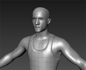

In this example, Mudbox detects the high-valence vertex on the left eye mesh.
With problem areas highlighted, you can examine each region to determine whether it can be fixed within Mudbox. (For example, by deleting problem faces and patching the hole. See Delete faces and Patch holes in a mesh.) More complex issues may require the mesh cleanup and editing tools available in Maya or 3ds Max.
